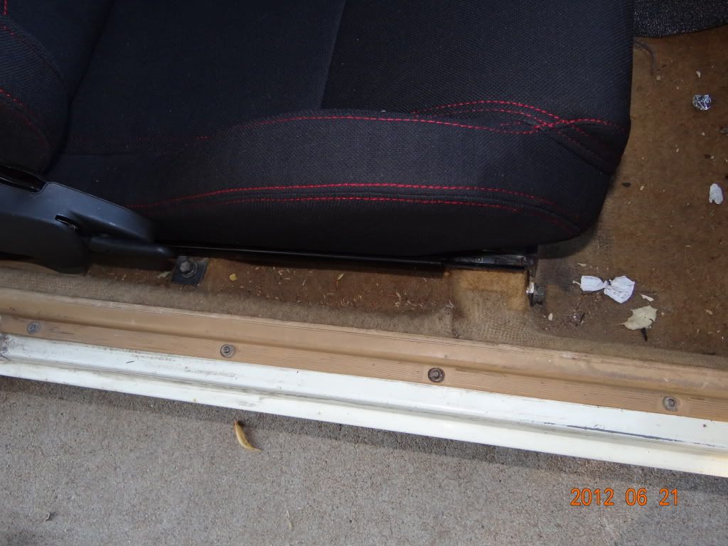

How they are installed.
LOL as usual i have the absolutely cheapest tools you can buy.
$100 welder from HF.
A cordless recep saw with 1&1/2" by 3/16" strap. A bit overkill I know but i had it already.
The off set bracket for the rear of the passenger seat. This keeps it level when the mounting points are not.
The assembly once welded onto the sliders.
Then installed.
The front part mounting both seats is the same L shaped piece but one side on each seat has an offset due to the sliders being closer together on the new seats.
This is how I did the rear of the driver seat as they were both different. I used a 17mm socket as a 1" washer and ground it at an angle to match the way the old mounting point angled.
How they look. Only $250 and two hours time. HELL OF A DEAL!

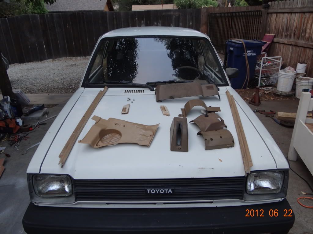

Last update today has me stripping it down to paint the plastic and install the new carpet. I will also be dynamatting the door speakers and doors. The pain of stripping it down right after getting the seats in is unbearable.:cry:
The first thing I did today was to install the carpet. YUMMMM.
MAN WHAT A DIFFERENCE
The seat belts are on order and come with new latches that are black to replace the brown seat belt latches. also has a new black rubber mounting cover for the pillar where the shoulder strap mounts. So perhaps by the end of next week I will be brown free, and one month after that I will call the interior good and move on the the body.
The last brown is the seat belts/latches and the Ebrake handle. (Seat belts and latches are on order)
