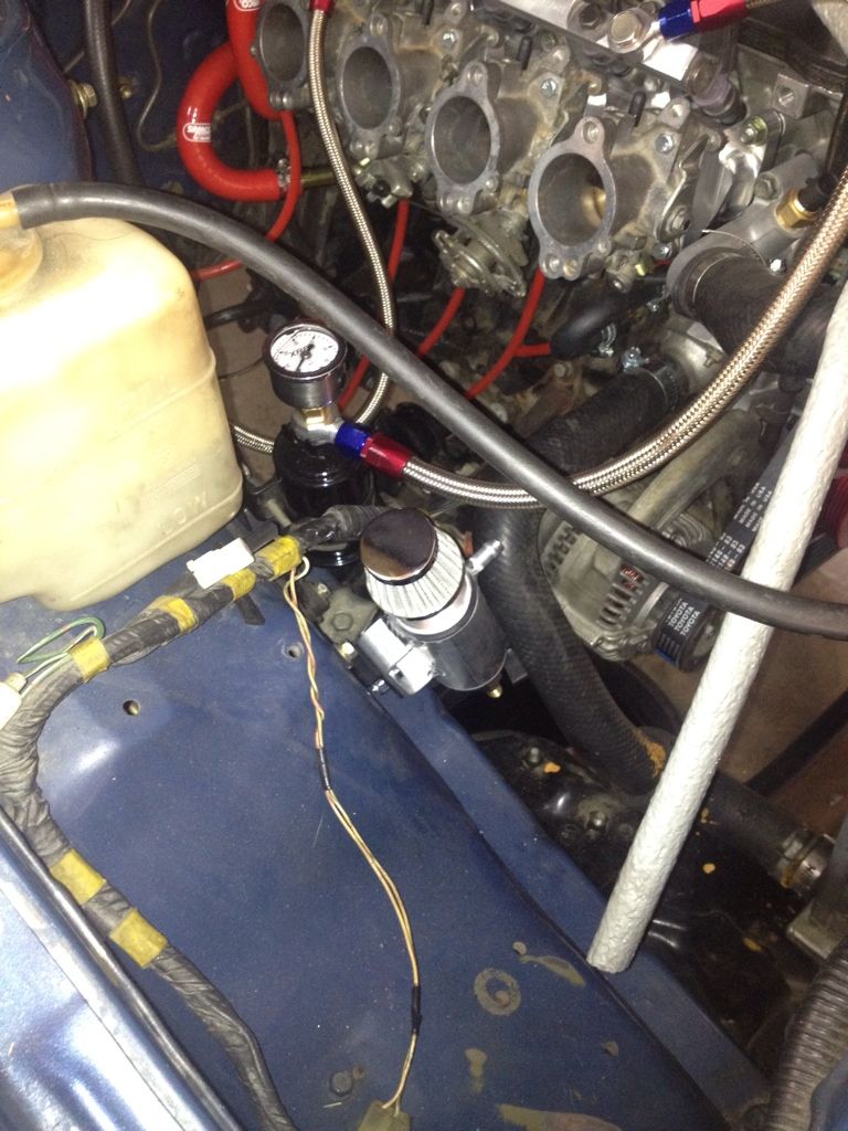

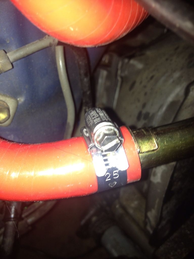

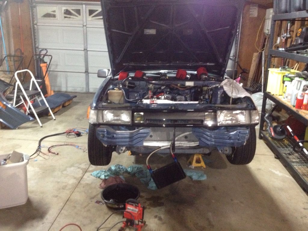

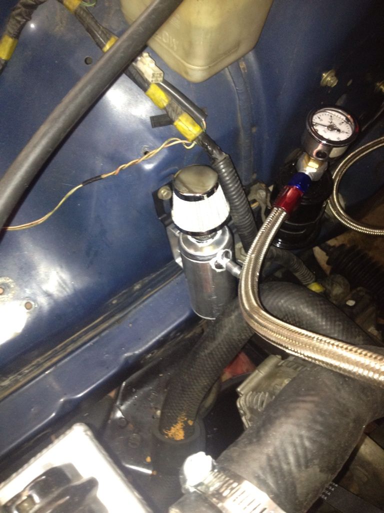

Finally got some more time to work on my car. I put on my hoses:
 I also found a place for my breather tank:
 And last but not least I started trying to figure out the wiring:
 I have never done any type of automotive wiring so this may take me a while. Tips and tricks would be greatly appreciated. My first question is how do I go about connecting one ground wire to 4 different fuel injector ground wires? Also, which wire on the injector goes to ground?

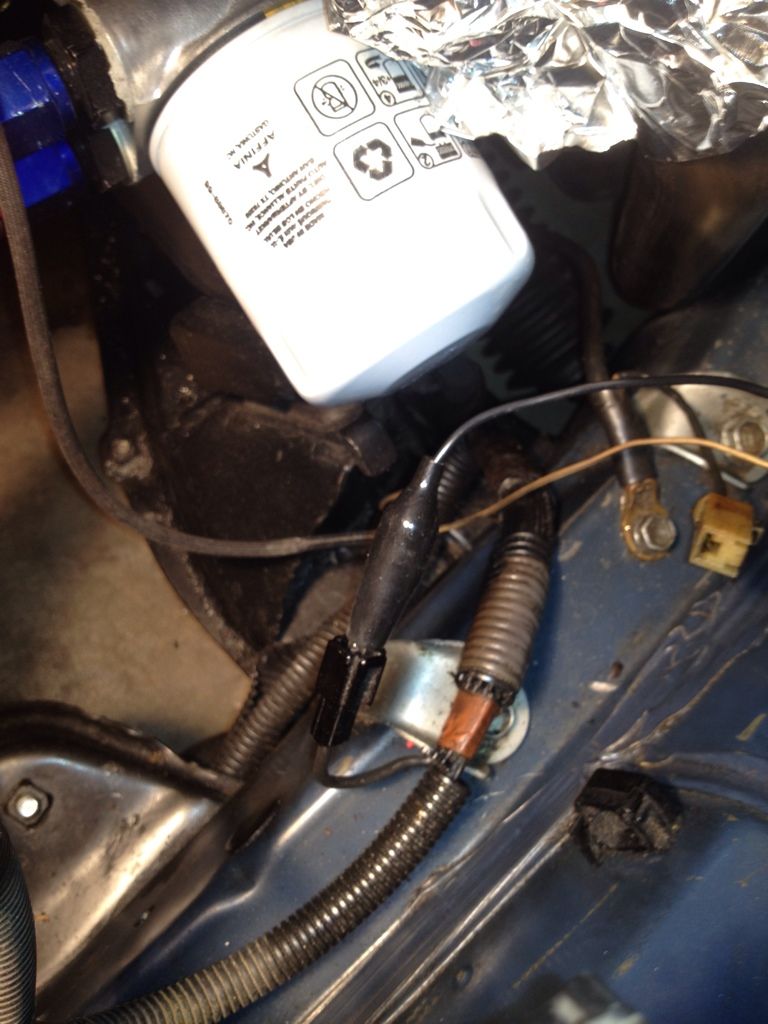

I am finally getting some wiring done! It looked like a rat's nest at first but now it's really looking good. Grant is the man and taught me a lot about wiring, performance and dub step. Haha.

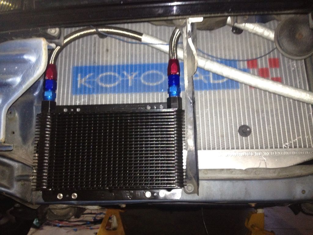

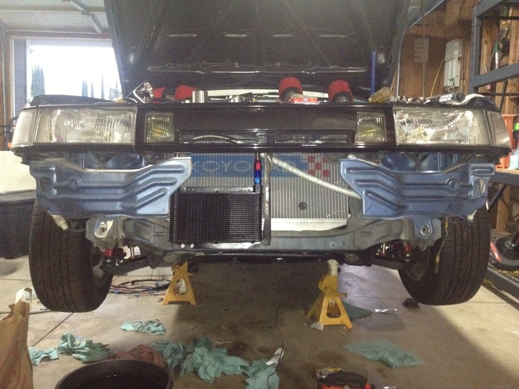

 I'm also trying to finish mounting my oil cooler.

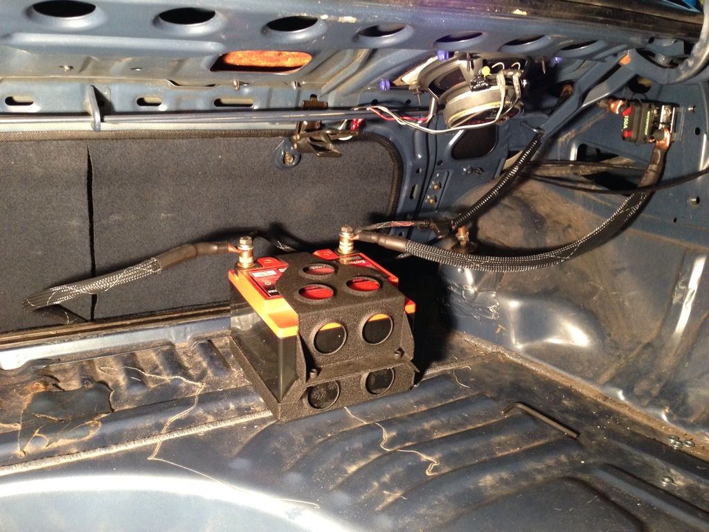

Alright, alright! Got lots of exciting stuff done!I had to adjust the valve clearance. It was way off! I had 3 shims with no clearance at all. I ended up needing shims smaller than available for the AE86 but I ended up finding them available for a 3SGE. I included the part numbers I got from Toyodiy.com.
 Got the oil cooler half-way mounted in. Used some self tappers and I still need to add a bracket to hold the top steady but good enough for now until the darn thing runs.

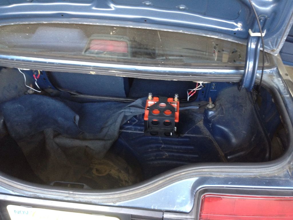

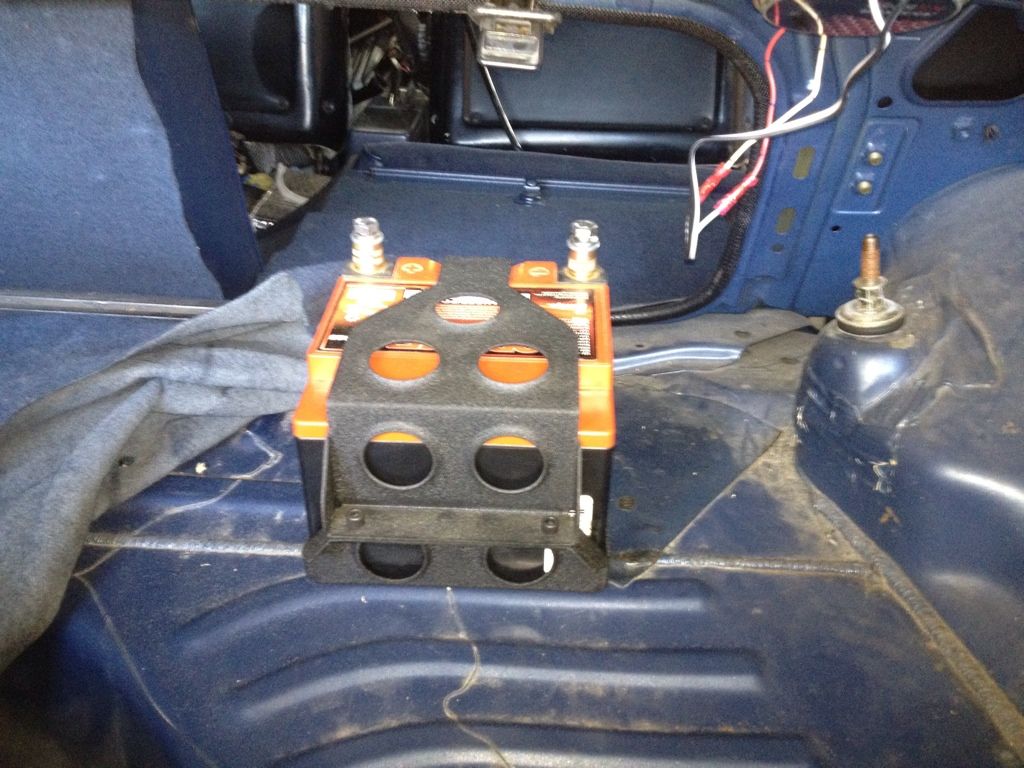

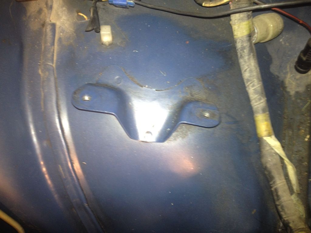

 I found that the perfect spot to mount the BMW battery block was where the coil used to mount. Fits great!

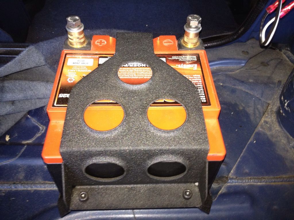

 I found a good place to mount the battery. There was not much space without dropping the tank. I tried to be careful but I almost drilled through a gas line. Phew!

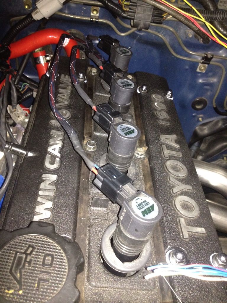

 So now on to the real good stuff! Grant finally had some time to get back down to Redlands. He got the harness looking great.
 Never mind the ugly mounting job on the coils. Those are temporary.

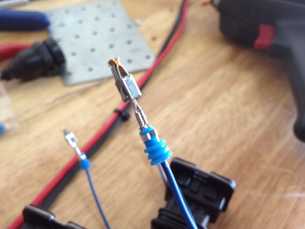

 The terminals and clips on the AEM stuff are pretty out of control. There are so many types.
 Here's a shot of the harness in progress:

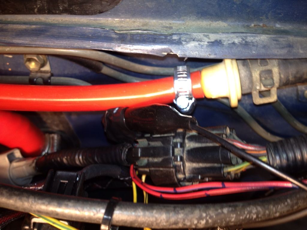

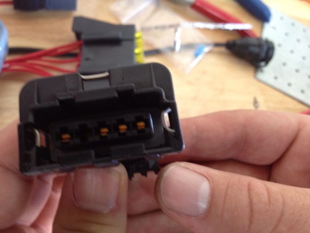

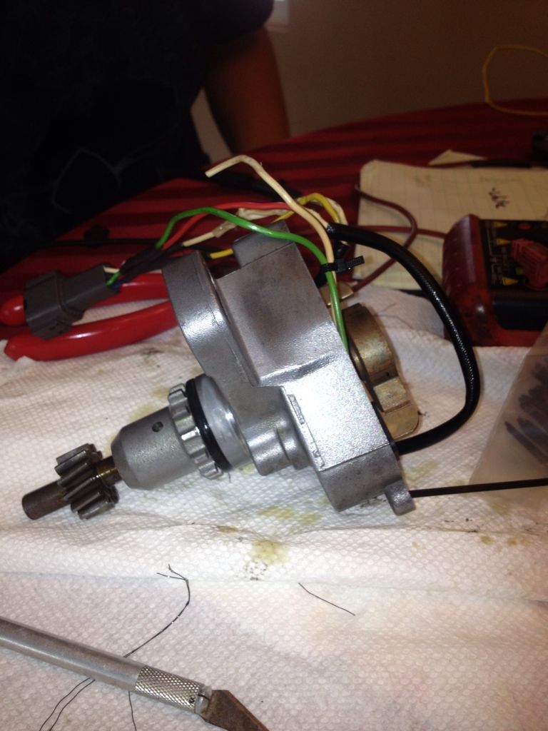

 So apparently getting the harness made was only the beginning of the work. One of the biggest things we had to deal with was the trigger. I am using the GZE CAS which only produces a falling edge signal. Unfortunately the AEM EMS 4 I am using only reads rising edge. To compensate we had to change the polarity of the CAS. I learned that normally you can switch the signal and ground however the GZE CAS has a common ground that has to be separated. Here's Grant performing Cam Angle Surgery:
 After this we got everything set but me, being the rookie mechanic I am, dropped a small adapter into the cylinder while the spark plugs were out. I ended up finally fishing it out with a magnet E taped to an 8 gauge wire.

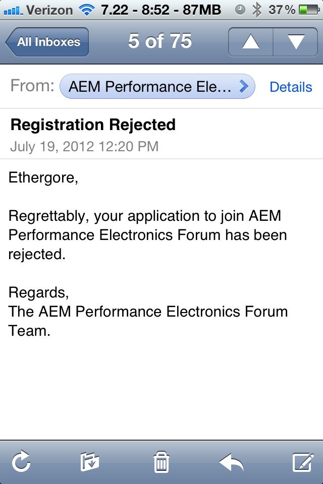

So to put it bluntly....AEM EMS 4 is pretty dang annoying! We had one problem after another getting this car to run nicely. It took an entire day of calling tech support and experimenting to get the EMS to stay connected while the car was running. We ended up having to try two different laptops and finally got it to connect by using a USB hub which apparently amplifies the signal and helps connect.
 We also had to set a password which is apparently a known issue according to tech support. The forum offers some help but you can't ask any questions because they won't approve the user name. That's right... They actually denied me the right to access their forum after spending all that cash on their products.

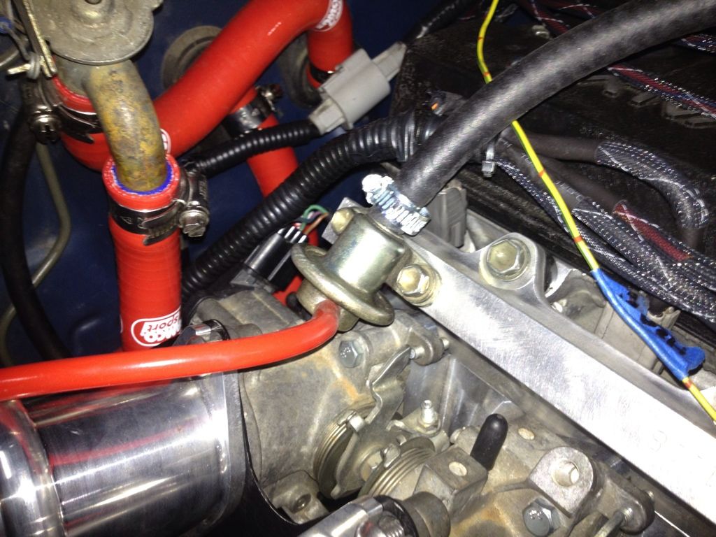

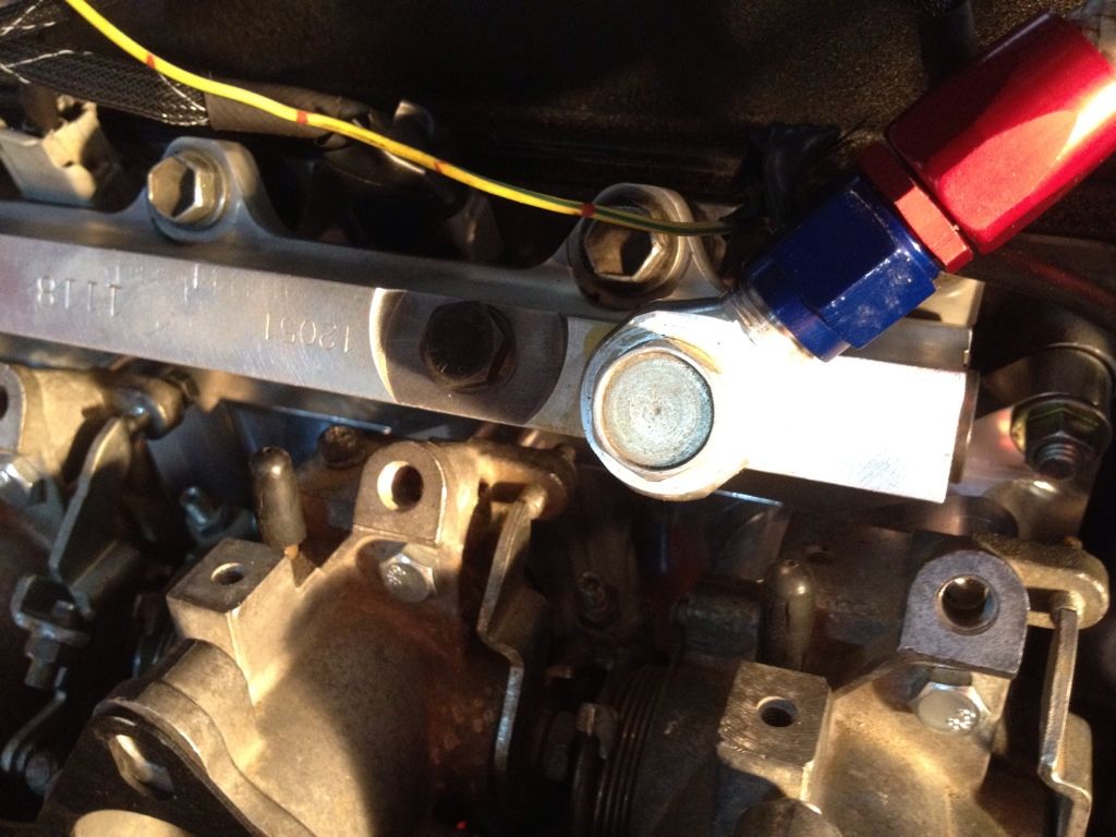

 Once we got the fuel pump going I found a fuel leak coming from the banjo bolt on the fuel rail.

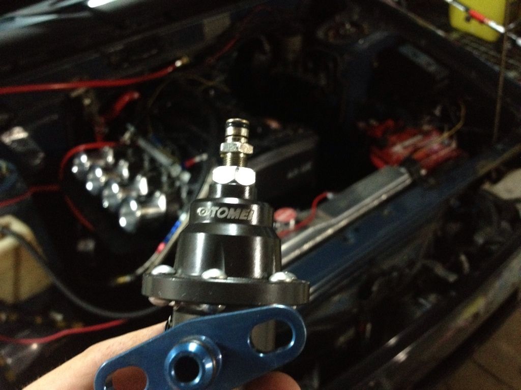

We sealed that up by using some yellow gas safe sealant and then we found my Tomei fuel pressure regulator was leaking.
 We took a trip to the junk and found a stock FPR off a newer Toyota which worked out but required me to go back to a regular line setup. Since my fuel lines are already converted to AN I ended up jimmy rigging my fuel line with what looks like a million adapters.

holy crap.....1st... kudos on the patience to do the wiring... I see all that crap and I get wound up... 2nd... AEM really sucks if they disallowed you from their forum. 3rd.... GRANT??? I know we didn't have enough work for you.... The 6 speed is in and works very nicely.... too bad the car s tune sucks

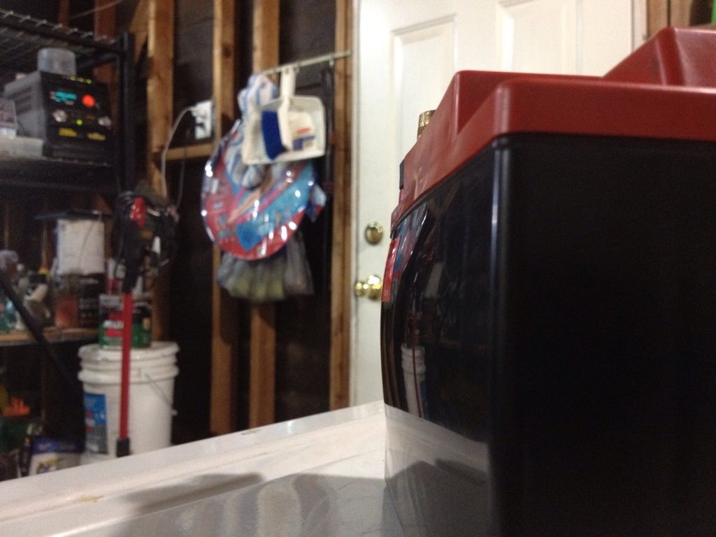

I kept having problems with my battery holding a charge. I tried one last time and left it at 10 amps for 4 hours and came back to it looking like this:
 After 2 weeks of waiting, the local distributor said they wouldn't warranty the battery. Im just glad the thing didn't blow.

stupidstuff
157 posts [100%]
The secret valley Ca
WOW is that a dry cell?

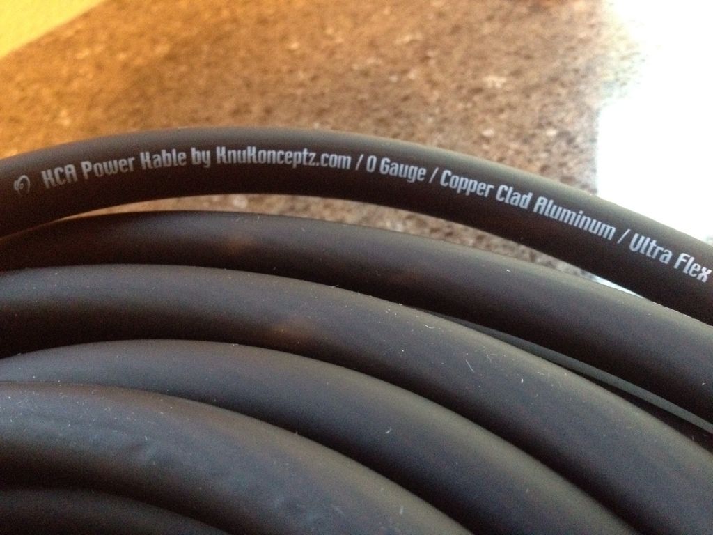

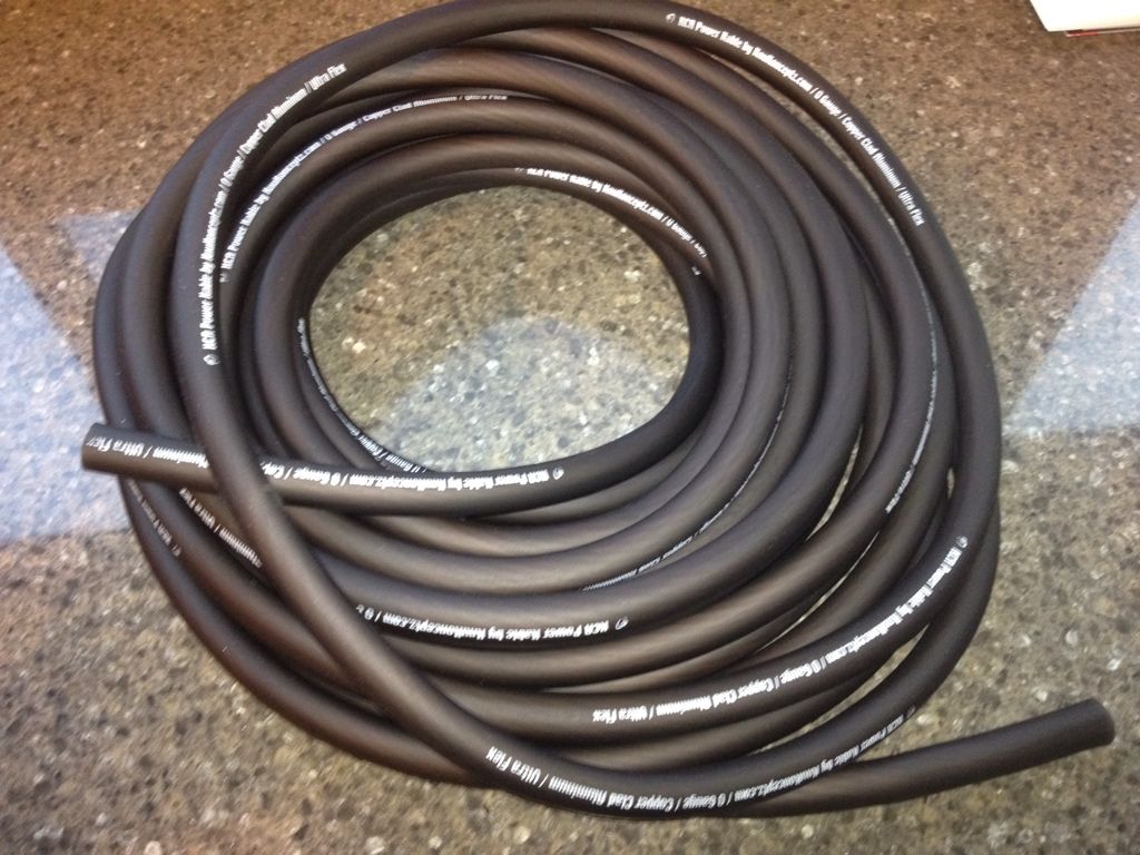

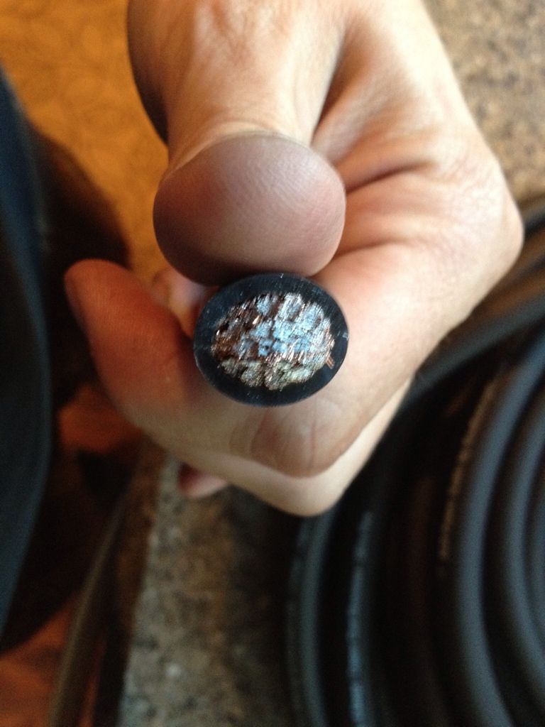

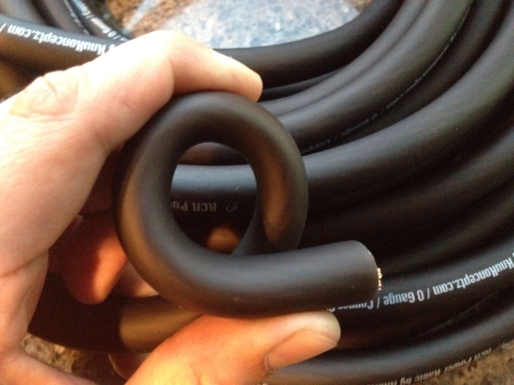

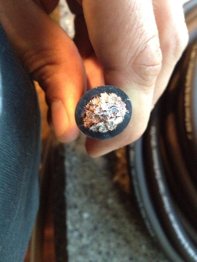

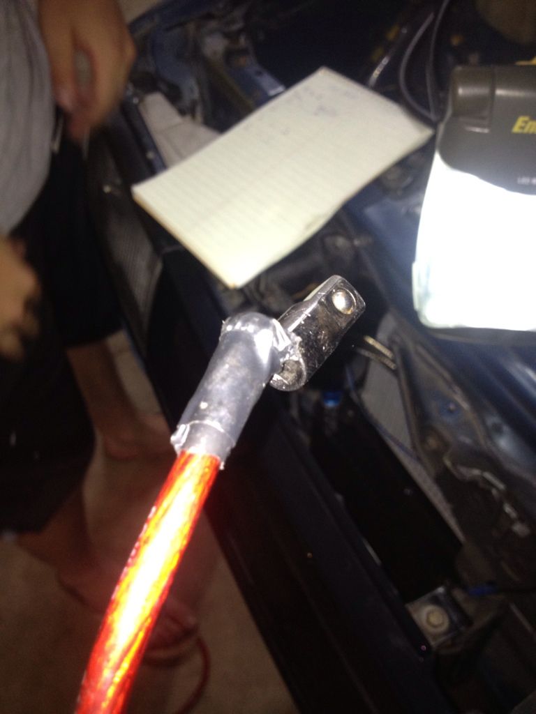

I finally found a reliable and cheap place to get some good power wire. I went overkill and got 50' of 1/0 gauge. Not sure what I'll do with the extra.
This stuff really is as flexible as they advertise.

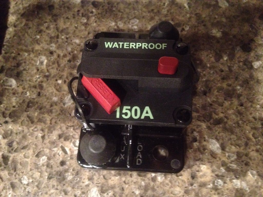

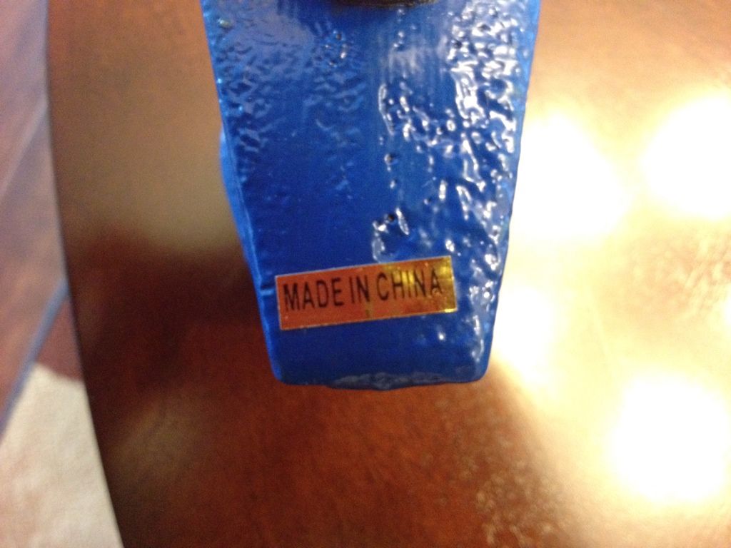

I also decided to try a 150 amp circuit breaker. I don't know why there is so much conflicting information about whether to use one or not and then what size to use. I figured the starter is on an 80 amp fusible link and that a power line shortage would be well over 600 amps. With that in mind I figure a breaker somewhere between the two should keep me safe. I'd be glad to hear any thoughts.
Jim4age
3 posts [100%]
Taichung
| Re: 16 valve ITB on AEM Management (ethergore1) » | 10:30 PM 9/2/2012 |
Reply
Edit
May I know what is this off from or there are shops you can purchase from. Thanks.
ethergore1
244 posts [100%]
Loma Linda CA
If your asking about the circuit breaker it's from o'reiley.

Jim- I guess I read your post before the picture loaded. I used a 4agze cam angle sensor. I had to have mine modified to be used with my EMS.

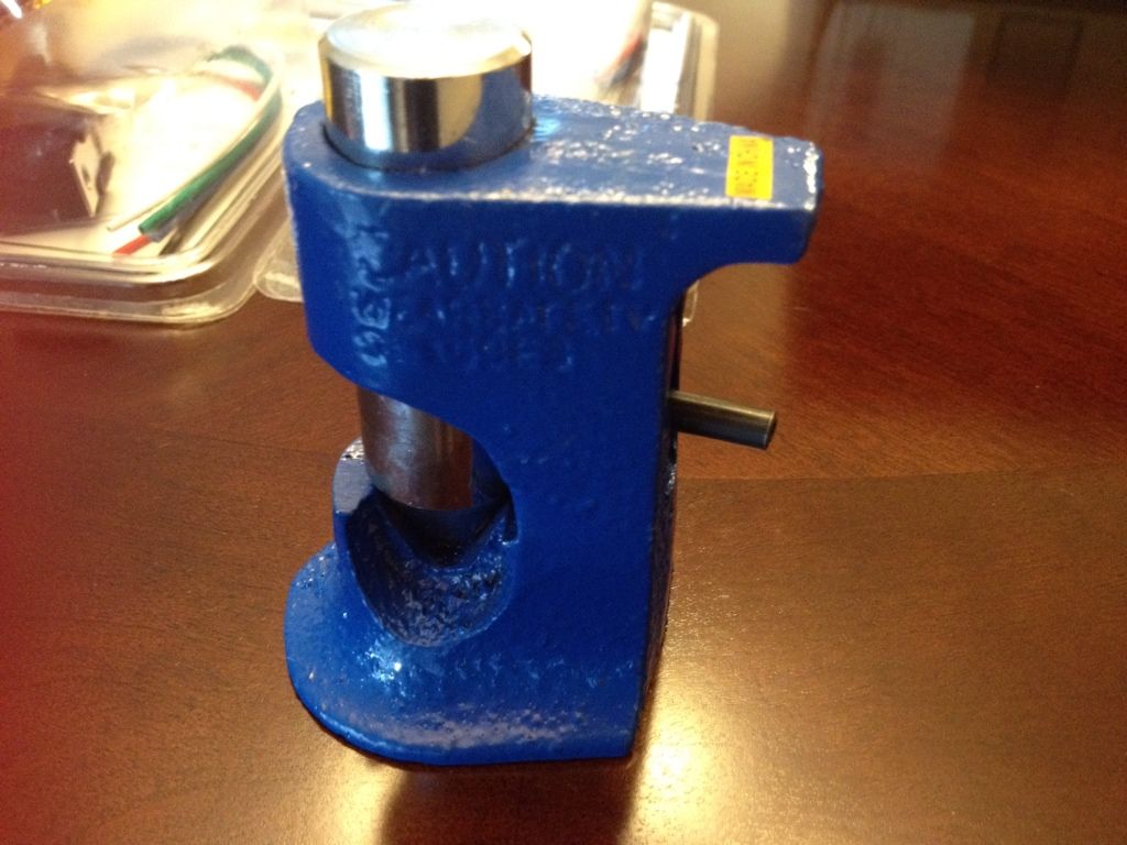

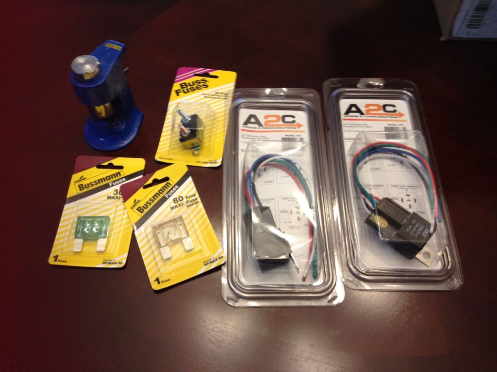

Got some more stuff in today to do more wiring:
 The crimper has the stamp of approval.
ethergore1
244 posts [100%]
Loma Linda CA
The crimper works like a champ:

I think I finally got my relocation completed to my satisfaction. I replaced my fusible link box with MAXI fuses. Also pictured is my relay for the fan, I'm still deciding if I want to try to hide it but I have so many things going to this area I kind of decided to turn it into a "power center." Still deciding....

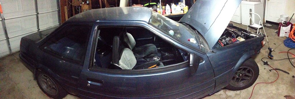

I got iOS 6 working and had some fun with panorama pictures. Here is a shot of how my engine bay looks right now(still very temporary) and a weird picture from the side. Pretty funny looking.
