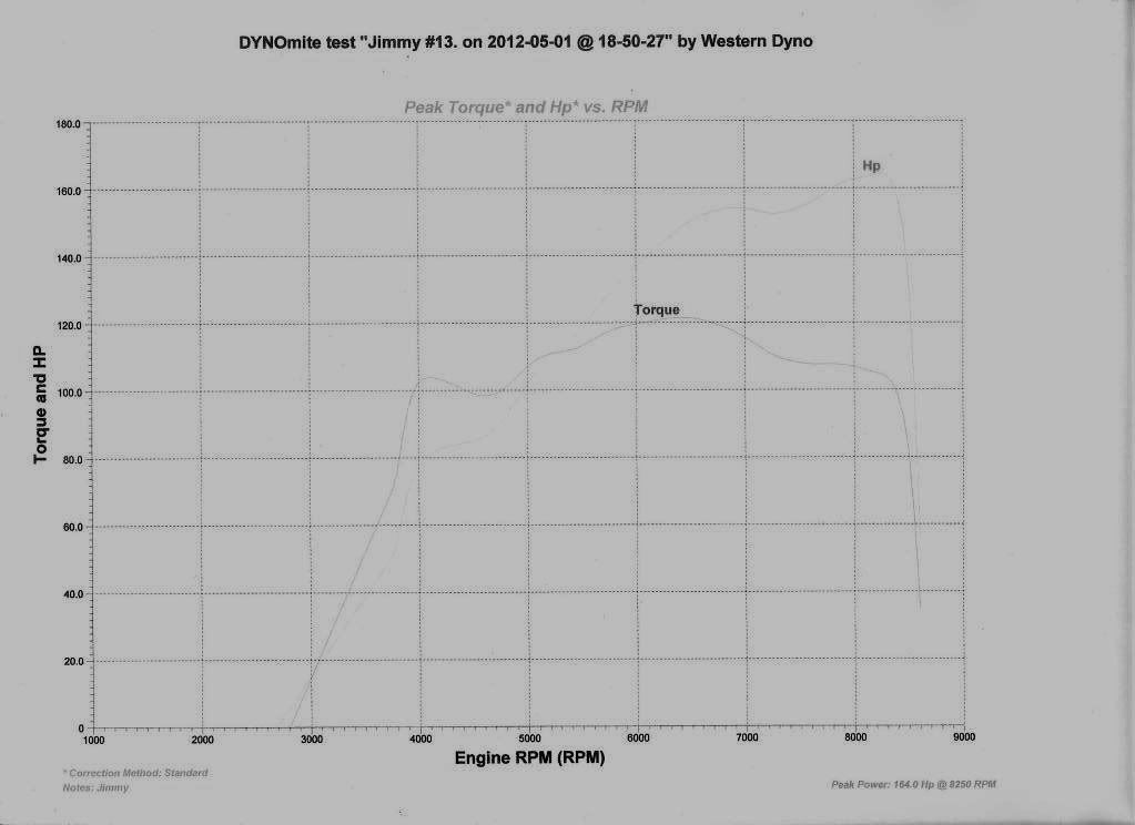

Sorry, no baseline runs with this setup. However just did a compression test on the engine, and since changing the camshafts the compression has fallen from 210psi to 190psi.
13133 posts [99%]
Portland
those numbers are flywheel rating, or wheel rating?Compression came down most likely because the Tomei cams have a later intake valve closing event.

Thats power to the front wheels. I have the exhaust cam at 107 degrees according to a toda cam pulley chart. However I know that the thinner head gasket shifts the timing a bit, so I can't really say for sure what the actual cam timing is.

122#/ft @ the wheels is VERY good... hp is also good, but the torque is a stand out

The car (AE92 approx 1900lbs with C60 gearbox) does feel quite fast. From the shape of the graph i believe another 5hp is possible if the rev limit could go to perhaps 8300rpm.

I'm going to dyno it with a Mine's ecu hopefully by next week. That ecu rev limits to 8300rpm. Not much more mods other than a 2.5 inch exhaust starting from the branch pipe (2 into 1) and an underdrive crankshaft pulley.

mad respect for you and that engine.... so would u say that the tomie cams gave u the high whp rating. good lock on the dyno run post some updates

Hard to say what exactly the cams gave but the upward slope of the graph at the rev limit is a good sign. Also on the positive side the camshafts dropped into the head and gave almost the same valve clearances as the standard cams. No shim adjustment was required at all. The engine idling when cold has the distinctive "cammy " sound but smooths out when it warms up. Theres no noticable drop in low rpm power. All i need now are a few more rpm's as it really runs to the limiter quite quickly.

ok to me the 158whp it pretty damn good for just i/e cams without EMS is real impressive to me my bt made 133whp sotck and if i can get that much hp without EMS i would be on cloud 9 lol how much u get the cams for and where u order them from?? been looking a set for a while

The cams I got through a local racing connection but I see them listed online for around US$600-650. Most stockish blacktops make around 135-138 on our local dyno. Now, I wouldn't say my engine in only running I/E mods. I figure I have gained 10-12whp between the headers(2-1 pipe), thinner head gasket and the exhaust cam pulley. Then factor in many hours on the dyno adjusting fuel pressure, cam timing and distributor settings. And remember I am using high octane fuel. One of the issues with the stock ecu is that it really pulls timing when any detonation/pinging is detected. I have seen where this can cut 10whp very easily. So for a daily driver you will probably need some good octane booster to reduce this. Of course a well tuned engine management system is the ulitmate answer but getting a reliable system and tuner can be challenging. So I have not gone that route yet.

Hey Jim, it's hard to know absolute power when all dynos have variation between them, but from the seat of the pants, do you feel like the Pon Cams made a big difference? Do they feel like they pull through most of the rev range? Worth the money?

New dyno run using Mines ecu. Probably could have got a little more but something flew out of the gearbox and through the bellhousing. So never got chance to adjust distributor or cam pulley. Gotta get rid of that dip around the 7000rpm mark. Was using straight avgas this time.

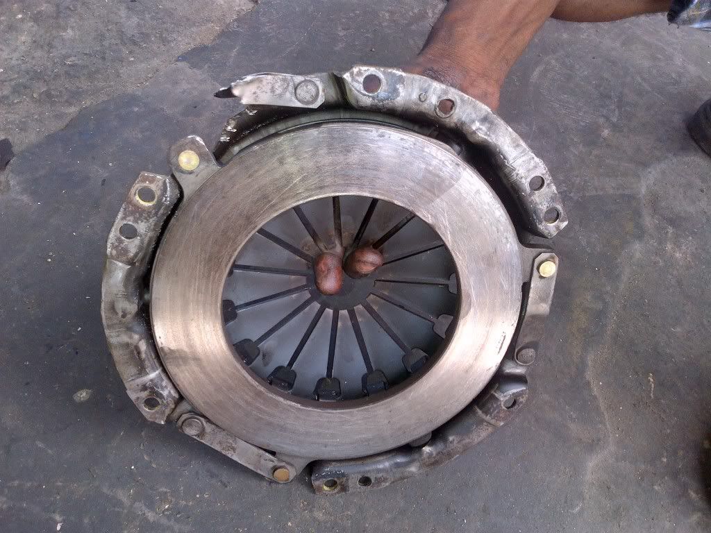

Thanks. My timing belt should be installed ok. Which would mean that my actual exhaust cam timing is closer to 105degrees. Might have to do some adjustments there when the car is back together. BTW found the cause of the gearbox noise. Piece of pressure plate came off and went thru bellhousing. The 8lb TOM's flywheel survived though.
