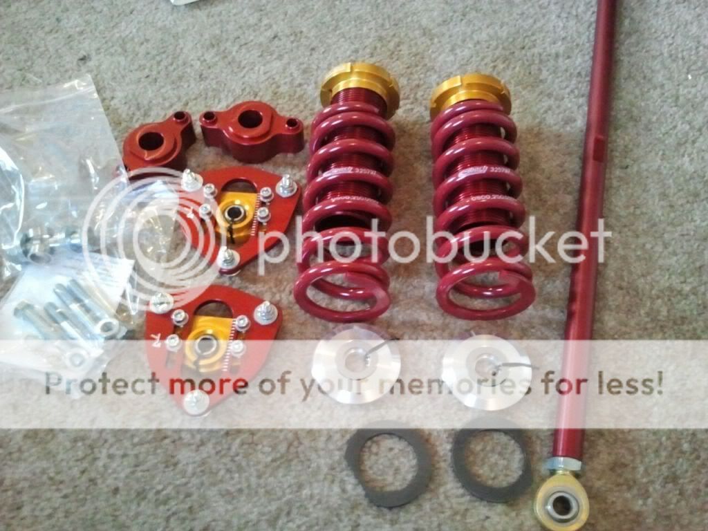

*front 10k T3 short stroke coilover conv. (Ground control setup)
*t3 panhard bar
*t3 camber plates

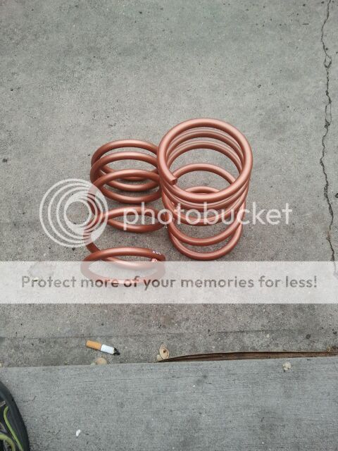

*TRD 6.5k rear ae86 springs

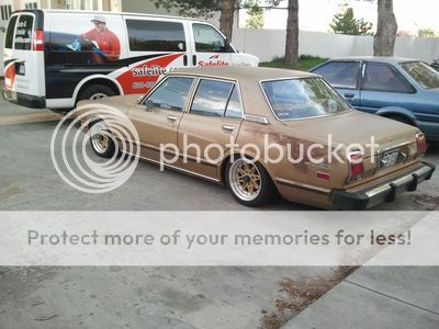

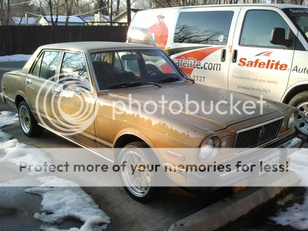

here is the car the day I got it with 70k
car sitting like a truck
in the air kinda
t3 stuff

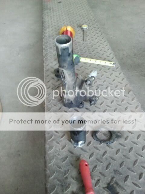

struts with the og perches cut off
40mm cut out
all welded up

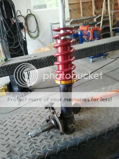

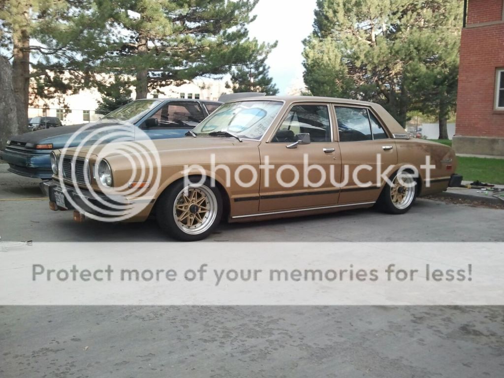

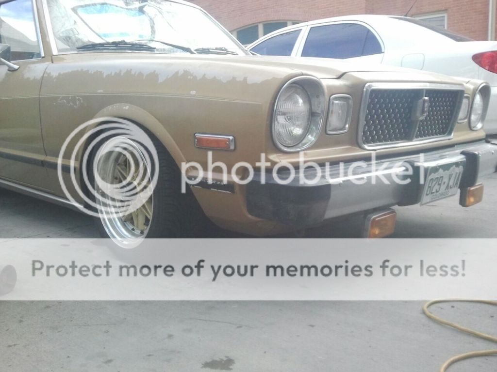

Small update front is done'ish and down still need some spacers and the correct rca's t3 is making me a set now..Still could come down some more but till I get the back stuff I can wait..the back set up and rear spacers are in the mail hope its here soon, cause I cant rock it like a 442 haha

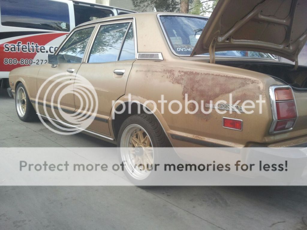

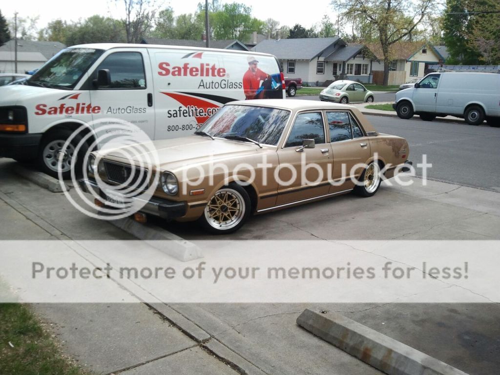

got the back down looks alot better..Still waitin on the spacers..Get the fenders rolled, front down lil more..

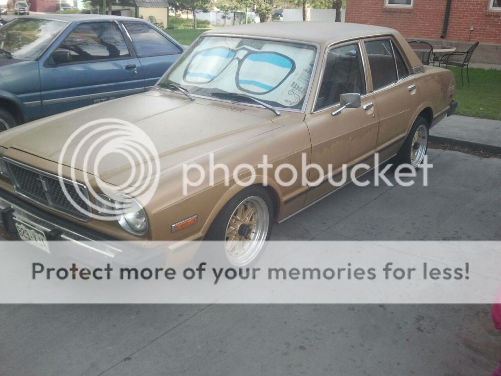

cleaner pics

Awesome build. I also picked up an mx32 and right now i'm looking into suspension work. What are the specs on the Rear springs?

ae86 6.5k's with lil work to fit the axle
