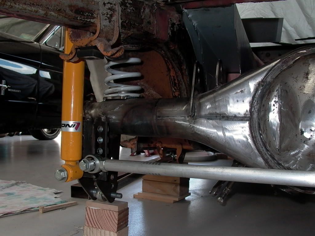

I cut down a Hilux/Surf dif (I dont know what you call them in the US) for my KP Starlet.
I think its what they call a "G" type which is 8". I had the axles cut down and resplined, I was able to shorten the housing myself and straighten it, I am running an equal length 4 link with panhard rod. All links are thick walled aluminium tube with rodends. I also machined down the axle flanges and redrilled them to 4x114.3. I am in the process of adapting on some Willwood 4 pot calipers and seperate mechanical handbrake calipers. I am using rear rotors off an Opel Vectra that are 10mm thick and fit easily inside my 15" wheels.
I am lucky because I can do all the fabricating myself apart from the axle resplining.
The photo shows the 4 link setup, there are adjustable springseats fabricated into the body above to adjust height/corner weights

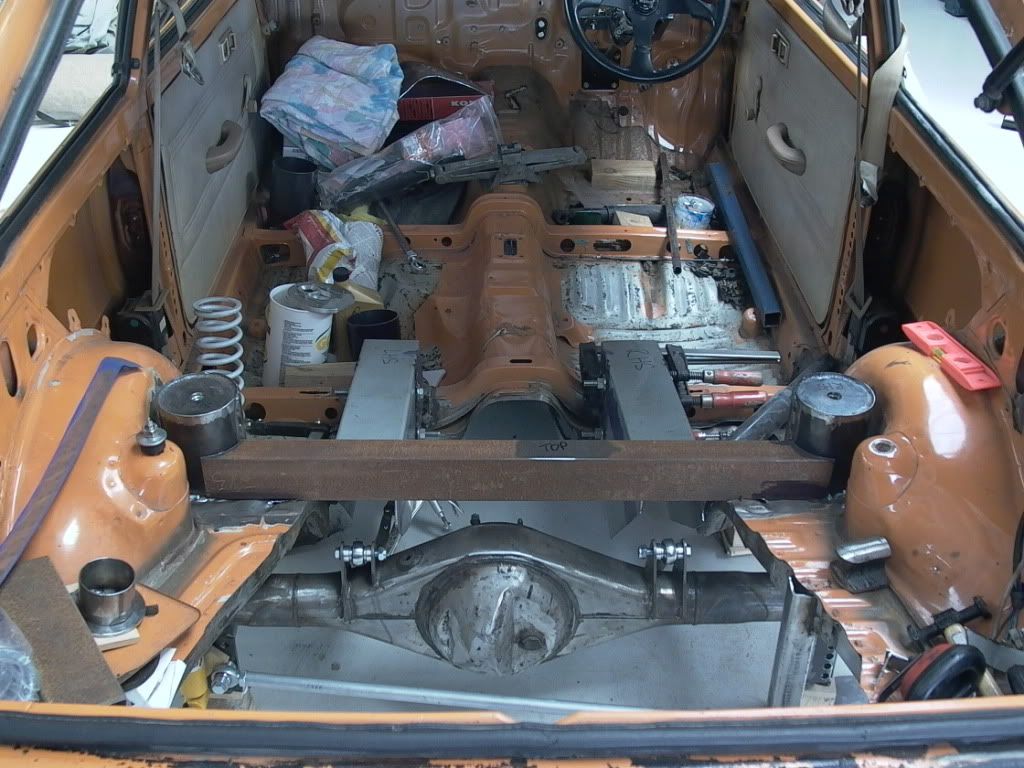

This photo shows the tubes for the adjustable spring seats, top link tubs and new rear crossmember. The vehicle is a lot further along now than these photos show
