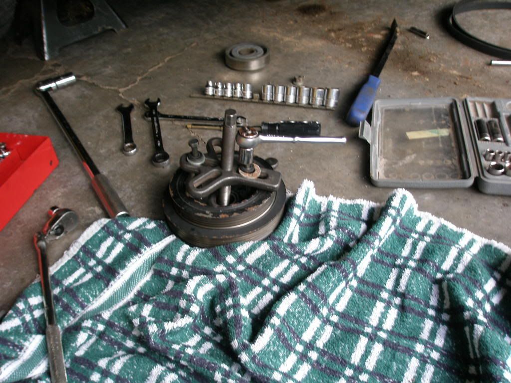

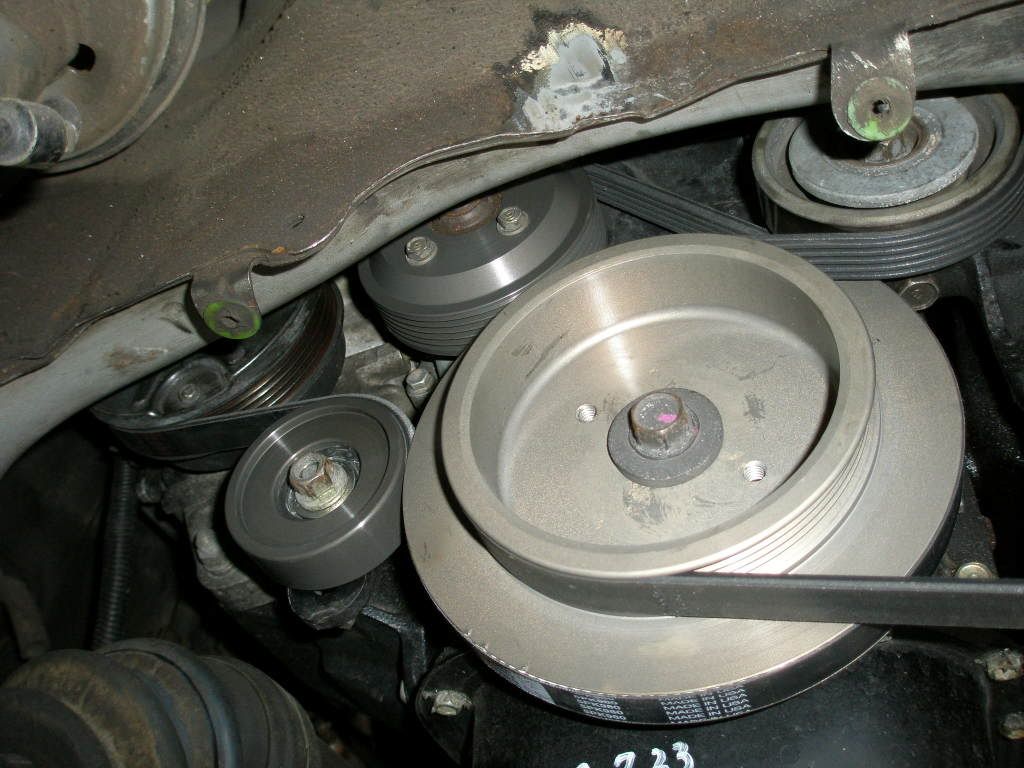

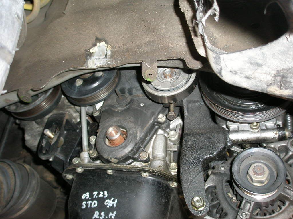

I just put mine on last week. I haven't been able to take it out for a drive yet. I've got my car torn down for suspension mods, and it may be another week before I get to.
Communication with NST sucks, at least it did for me (I know things can get crazy around the holidays). I sent a few emails after I ordered it trying to confirm that payment was recieved, but got no response. Eventually it just showed up at my door. Took about 4 weeks if I remember correctly.
The quality of the kit is good except for one thing. They powdercoated the crank pulley, but didn't plug the center, so I had to remove the powdercoating before it would fit the crank.
All in all, I am pleased with it.

First off I have to point out the customer service: when I ordered the kit back in Spring of 2006 I had to wait 3 months to get the thing. The website said they were in stock but it was wrong. I understand that sort of thing happens, but then if I was lucky enough to get a reply I'd get strung along with a BS reply like, oh it'll be ready in a week or 2. A month later and I've heard nothing so I started emailing again and the first few get ignored so I start sending nastygrams. This process repeated itself a few times before I finally got the damn pulley.
Now for the good, the fit of the pulleys was exceptional, I didn't have to scrape anything. The belt is a POS, I burned that up in about a month. The unsealed bearing only lasted a few months as well but as far as the pulleys themselves go it's an asolute steal for $300. I did manage to destroy my crank pulley (my own personal error, no fault of NST) and when I came crawling back for the second one I had it within a week so I don't know what to think now.
