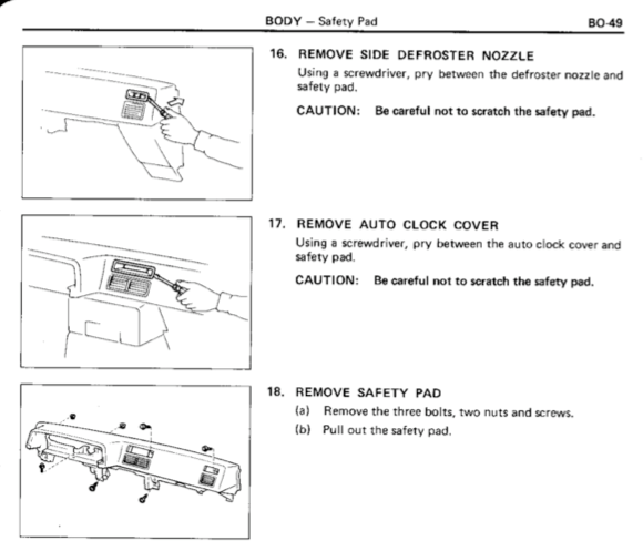

I got stuck on removing the entire dash, but I got out the main heavy crap, so I'm going to put it all back together later. I couldn't get the gauge cluster surround/cover off with the steering wheel in the way, and I didn't want to drop the column. Plus I couldn't figure out how to get the main dash pad off? I found a couple brass-colored bolts in the center and passenger side, but since I couldn't get the gauge surround off, I gave up. I did figure out the crazy light/wiper switch removal procedure though. 17mm socket and man-hands did the trick. Who needs a manual?

Quote, originally posted by Eric’sFreeAE86 »
My carb should be on the way, and I need to put the interior (or lack of) back together. My taillight panel is still rusting away slowly and I really really want to replace that whole panel. Anybody cutting up a car?
Dropping the column is two 14mm nuts. Very easy.
Make sure you get the 10mm bolt all the way on the right, under the mini-vent. 'Man-hand' the mini-vent. If you have an intact clock bezel, don't bother trying to take it out, as it will more than likely shatter, but there is a 10mm bolt under the bezel that holds the dash to the chassis. You'll have this annoying little plastic clip under the dash that holds it to the chassis. I lightly pushed the whole dash up and down to pop the clip loose...
DON'T USE A SCREWDRIVER!!! On these old dashboards, they tend to crack if you pry or poke at them!!!
