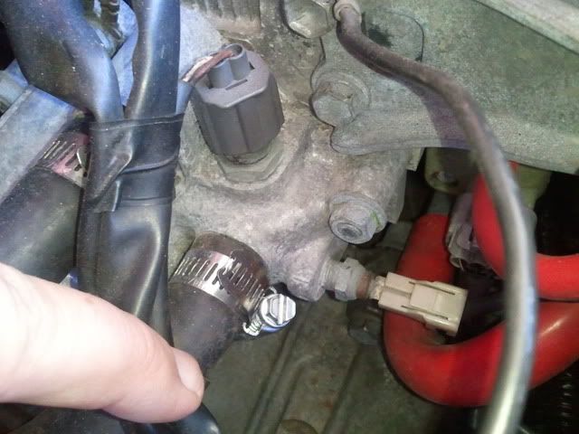

ECU water temperature sensor hooked up and working ?

Almost certain it is, I get temp signal to my dash gauge, also my engine warms up ok... I'll double check though.
Out of curiosity, how is that related?

 Re: 20V BT in a 1986 MR2, 2500-4000 rpm cuts out...What now?? (IXVolt) » Reply  Edit
Yep it's connected.
If the ECU doesn't get a water temp signal, AFAIK it defaults to "cold" and will run
rich. Would probably bring up a fault code as well.

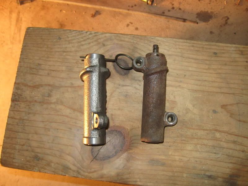

Brand new timing belt tension-er.
